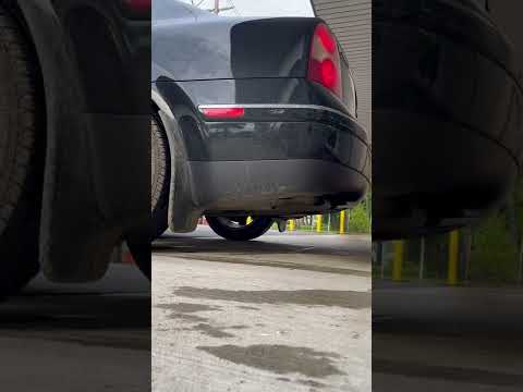

Driving home yesterday car felt really sluggish. Look behind me and started getting some black smoke. I think I hear some escaping air from under the hood under boost but I check all the intercooler piping and can’t find a leak. In addition the brake pedal is really really soft, right to the floor. I know the vacuum pump contros the turbo and brakes. Could that be it?
Attaching a video of free revving and one load revving. Lots of smoke

Good diagnosis. . The vacuum brakes and vacuum to turbo are both part of the same vacuum system. Should be easy to locate since it's making noise. Check from the vacuum pump to the brake boost. That's a common one. A temporary fix can be RTV applied over it. That should bring your power back and get rid of the extra smoke.

It can be that too you're correct. Let us know what you find. Do you have a way to test the pressure side for leaks? If not search it there are a lot of threads on how to .
