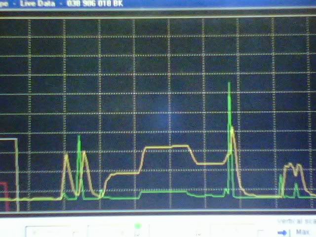

6) I ran VAG-COM and went to measuring blocks group 11. I was told that the graph lines should stay realitively close together but when I gave throttle they didn't.
Does this mean that the turbo vanes are'nt sticking? Is it a bad N75? Any help or suggestions would be appreciated!
