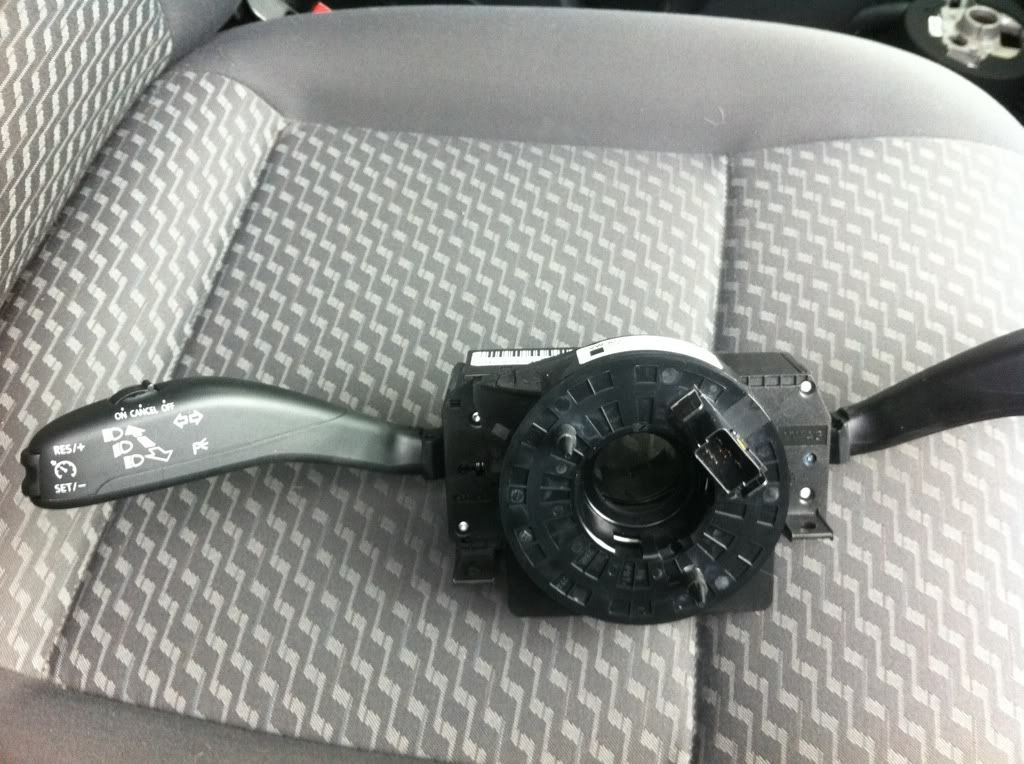

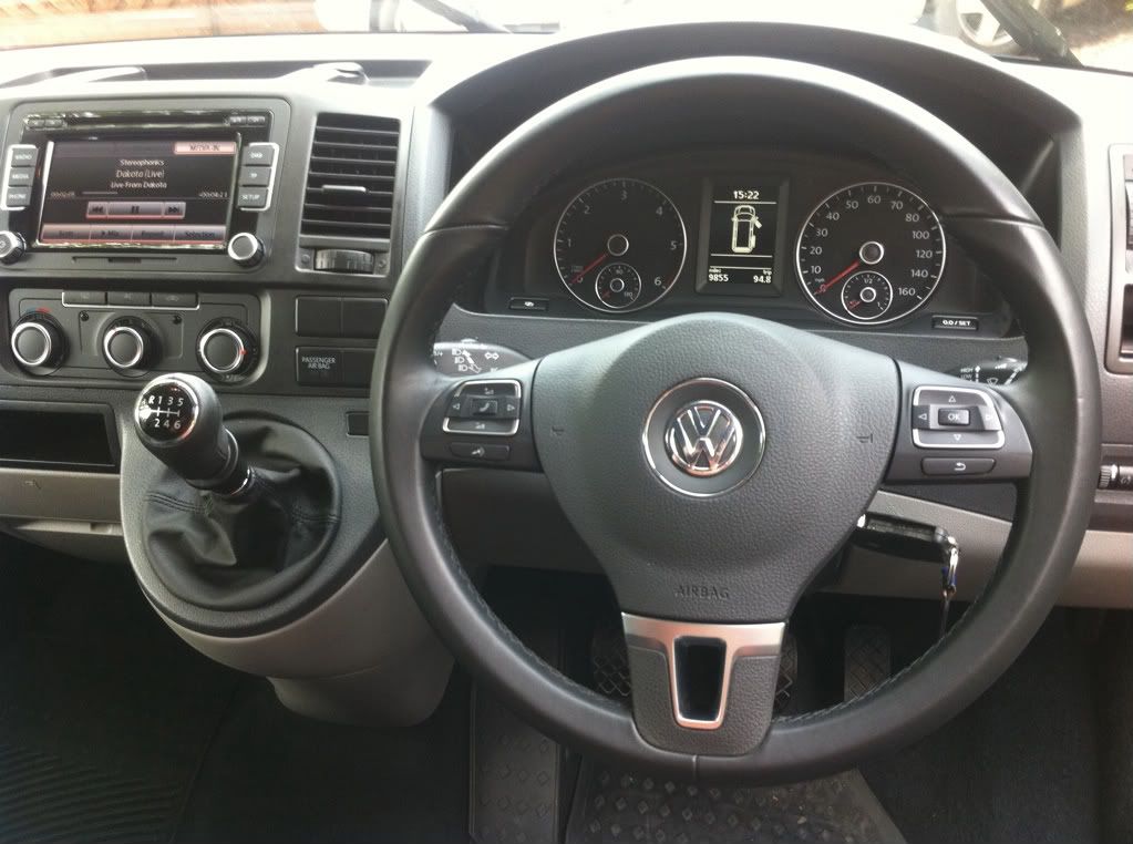

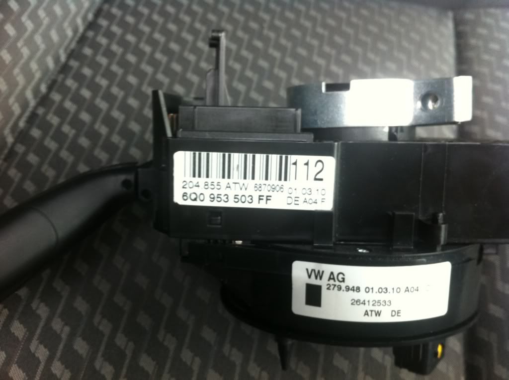

I am trying to retro-fit a MFSW to a 2010 transporter, the wheel is off a 2010 golf and I have the correct airbag cable for it,
now I have been told that the transporters are the same as the polo's and do not have a steering wheel controller and I may have to swap the central electirc controller, but as I have already got cruise control It may just need coding ?
Any help would be much appreciated
a few pics
