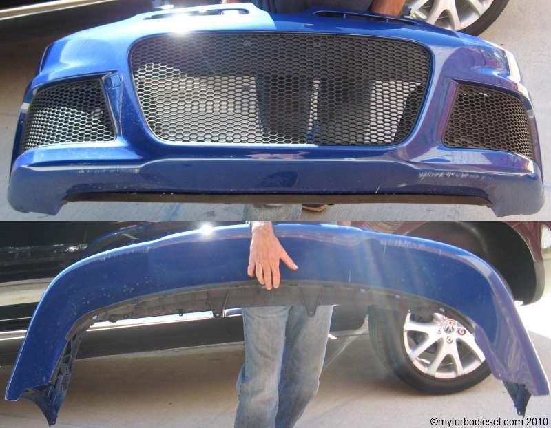

The thunderbunny body kit on the 2010 VW Jetta TDI cup edition is different enough to require another DIY article vs. the regular front bumper. For example, the license plate was removed just to check if there were any screws in that area like the regular bumper but there were not.
The full writeup is here- some teaser pics are below. http://www.myturbodiesel.com/1000q/a5/jetta-tdi-cup-edition-bumper-thunderbunny.htm

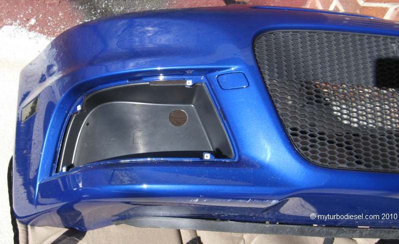

As a side note, it doesn't give any better breathing to the intercooler because starting with the A5 platform, the TDI have front mount intercoolers. It's behind the air conditioning condenser and in front of the engine coolant radiator. The larger side grills are blocked off but they have a hole for foglight wire routing.
