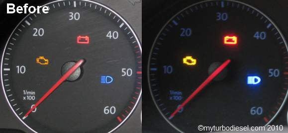

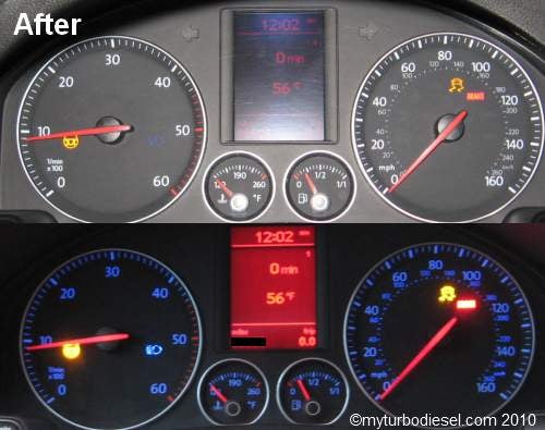

Unless you're in the city, it's better to have low instrument cluster lights to preserve night vision sensitivity. Unfortunately, when you use the high beams, the high beam LED turns on and it's super bright and pointed at you. I removed the gauge faces on the 2006 VW Jetta TDI and dimmed it by using a marker. Interestingly enough, the gauge face had spots for a convertible top and DPF even though my car wasn't equipped with any such devices.
I also turned the speedometer needle slightly to make it more accurate at highway speeds.

Note that most of the lights in the picture aren't on while driving so really it just lowered the high beam indicator to the same brightness as the rest of the cluster.
