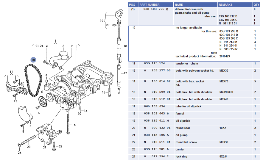

chain: no part number is given. It says to buy another module. I'm not kidding, I looked up the part number as I was typing this reply and it's been removed. Sorry. To show I'm not being obnoxious, here is a screenshot.
