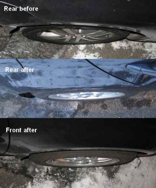

Since these came off another car, the offset is also too low. They stick out about 1" further and about .5" too far. The inside clearance is the same but there's plenty of room on the inside. If you get 7.5" wide wheels I suggest an offset of 50. 7" wide could get by with 45. You don't want to have the wheels stick out too far because this changes the scrub radius the tires spray the sides of the car with dirt. They work on the Passat because there isn't very much inside clearance due to the multi-link suspension. On the Jetta with it's strut suspension there is plenty more room for tuck-in.
Here is an pic showing the front with the new wheels. It's not just the angle, it sticks out too far by about .25", if it were tucked by about .5" that would be even better. This would be an offset of 48. (stock is 50).
Here is a before and after of the rear. The front and rear wheel hub offset is different so how far the same wheel sticks out will be different on front vs. back. 37 offset with 7.5" wheels is OK on the back but too low on the front.
