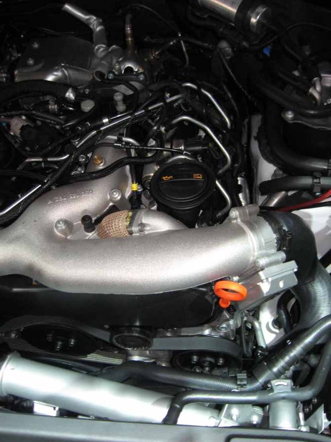

Engine cover off - the turbo is in the middle between the cylinder banks. The large silver Y thing is the air intake piping.
Left and right cylinder banks.

:eek That looks like a bear to work on,, but I wonder what kind of power mods would work on it. At least the turbo looks like it's easy to work on. What do the common rail injectors go for?
