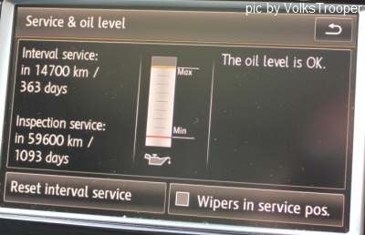

I don't know how I feel about it...and it doesn't matter since I don't own one but my general opinion is that while it's handy, a physical dipstick should at least be on the car somewhere. For one thing, does this force you to do the oil change through the oil filter housing instead of the dipstick?
Is there a physical dipstick option? It's not like seeing the color of the engine oil makes any difference since even new TDI engine oil is turned black from the little bit of carbon coloring the leftover oil pockets when doing an oil change. So maybe this is better.
Thanks to VolksTrooper for pointing this out and providing a photo. It's been added to the buying guide for the 2011.

Electronic dipstick
Ive been driving a Sprinter for 3 years, and when new I checked the electronic display against the dipstick 3 times. Assuring myself the sit in the car & check function worked as advertised, I never touched the dipstick again. I like it on my 2011 Touareg TDI.

I have no problem with an electronic oil level system as long as they have a backup dipstick for confirmation.
We had a BMW brought into the shop with an oil level problem. The customer stated that the oil level light came on so she put in a quart of oil as advised by the owners manual. The light was still on so she brought to us. There is no way to check the oil so we had to drain and measure it. There was only 1000 miles on the oil so we measured it, found it one quart overfull, and put it back in. Wonder of wonders, the level sensor then worked.
Makes me wonder what you would do on the road if that happened, far from anywhere. How would you confirm oil level? Give me a dipstick anytime, sure it is low tech, but some things should stay that way.
