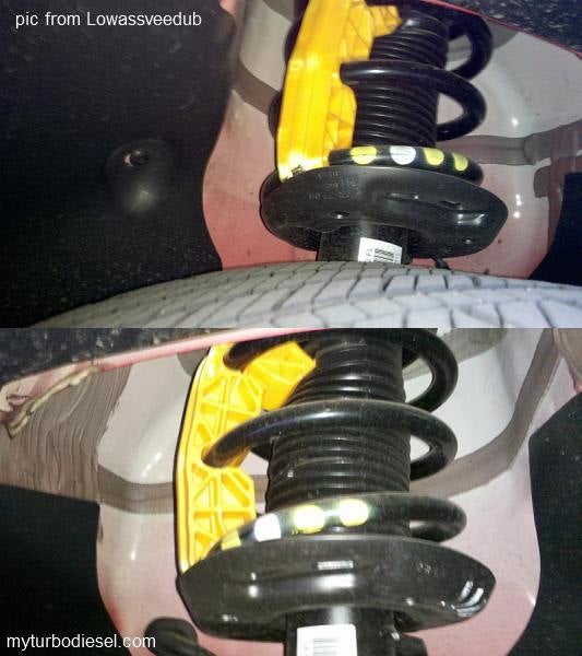

Even though this has been a problem for years, dealers are still not doing the items on the pre-delivery checklist. One of them is removal of the shipping blocks from the front struts. This will make the car ride high and stiff.

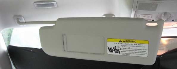

The sunvisor slides out to help block the sun. An example is below.

Hello,
There was a question below regarding the sunvisor and if they slid out.
My 2011 TDI Highline has the slide out sunvisor.
Super Moderator
Discussion Starter #3
Thank you, post edited. Do both the driver's and passenger side slide out?

Added 2012 notes and pics of the spring spacers, pic mirrored w/permission from lowassveedub. It looks like dealers are still leaving them in place. Since you paid for pre delivery checklist, they should at least do the items on the checklist.
