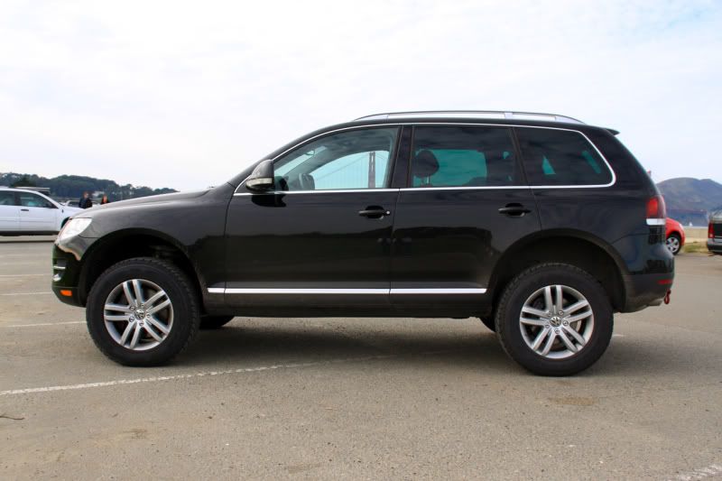

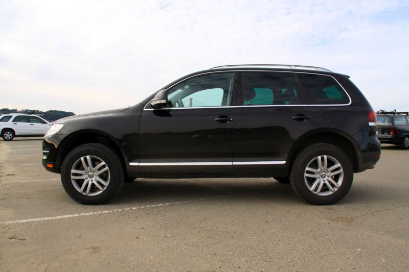

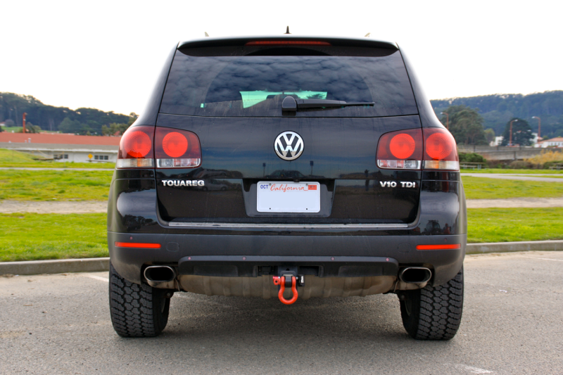

I know a couple of people are running these Audi Q7 wheels on their Touaregs, but I haven't seen many full vehicle pictures of them on the vehicle. These are an unknown name, 18" x 8.5" Audi Q7 wheel. I mounted size 265/60 R18 Goodyear Silent Armors on them.
I love the Silent Armor tires, I had them on my last vehicle too. They are rated for sever snow and ice service and branded with the mountain / snowflake symbol. This is a must for me, as this vehicle will spend a lot of time up in Tahoe in the deep snow. They are much quieter and offer a better ride than the 275/45 19 Goodyear Eagle LS2's that they replaced. . .not to mention will allow the Touareg to actually get into a snowy driveway.
Here are some pics of them on my 2008 V10:
Clearance in the front wheel well intercooler vents (no way the 65 profile tires would fit):
Load Level:
Off Road Level:
Xtra Level:
