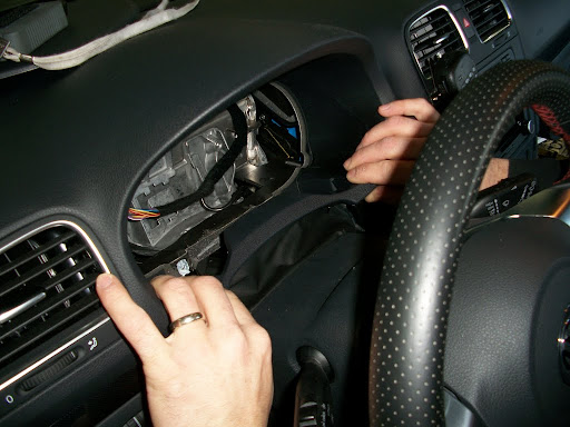

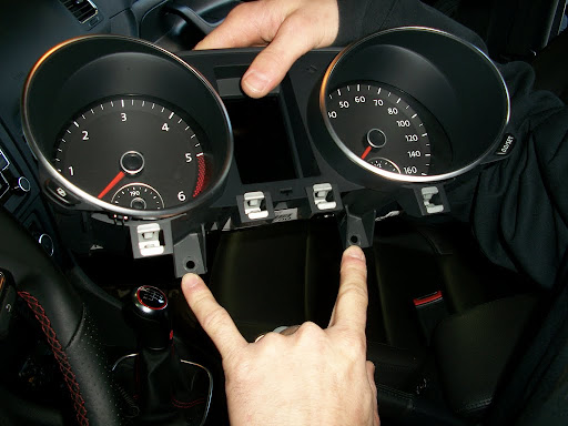

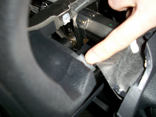

We need space to work. So first things first, we are going to remove the cluster. You need to unclip the trim in front of the cluster to access the two screws that hold the cluster in place. Gently pull on this trim to release it.
Now, you will see the cluster's screws. In this picture, notice the 4 silver clips above the 2 screw holes being pointed out. This is how that trim is held in place. Remove the two T20 screws that hold the trim in place.

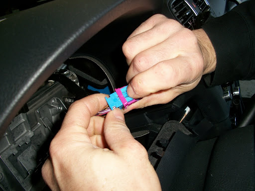

Now, you need to remove the harness from the cluster. On the back is this blue connector. To remove it, press down on the little tab as shown in the picture, and then rotate the pink part of the connector up, this will release the connector from the back of the cluster.

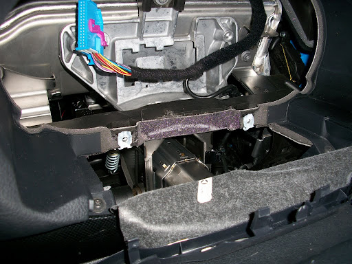

Cluster is out! See that T20 screw in the bottom left of the picture above the black trim on the dash? Remove it. The second picture shows its location too.

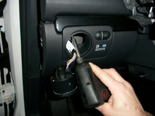

Remove the headlight switch. To do this, put the switch to 0 (off position), push the switch in (towards engine), and turn it clockwise. This will release the little arms inside, to allow you to pull the headlight switch towards the rear of the car, and out. Unplug the harness from the headlight switch and remove it. Then remove the T20 screw at the top behind where the headlight switch was just located.

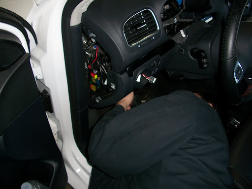

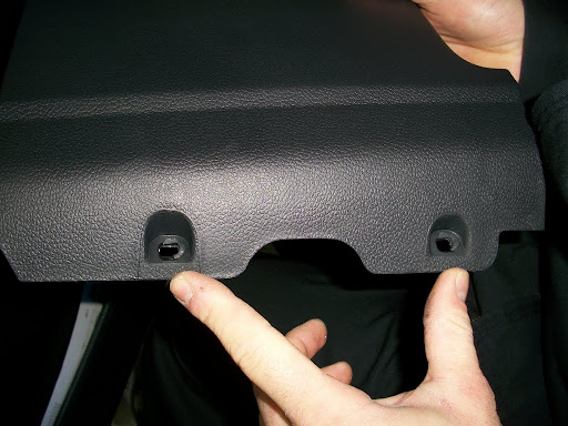

Contort your body underneath the dash to remove the two T20 screws holding in the bottom part of this trim panel. The second picture shows their location.
Unplug the rheostat and the trim panel is free!

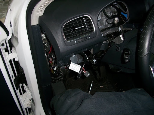

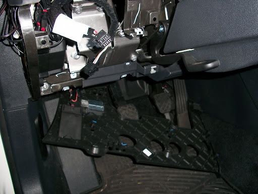

Now remove the kick panel from underneath the dash. This houses the OBD2/diagnostic port, the footwell lights, etc. There are 5 T20s that hold this in place. Once it falls, disconnect the OBD2 port, and the footwell light connector.

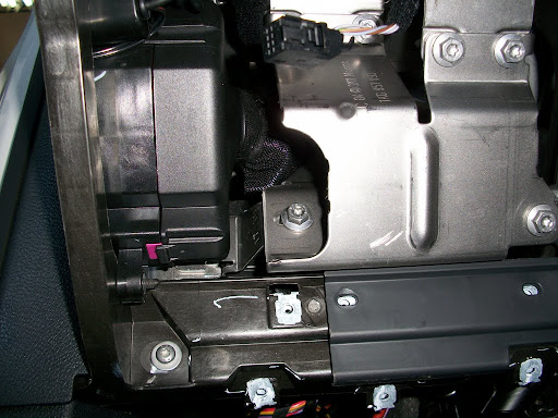

The next order of business is to remove the metal bracket pictured here. There are 6 (I believe) 13mm bolts holding this in place. Remove them, and pull the bracket out.
Also, take notice of the back of the fuse box that we are looking at in the left side of the picture. That black piece in the back needs to be unclipped from the front in a later step.
Take the surrounding trim off of the dash and remove the screws that hold the fuse box in place. Then, push it back into the dash and remove that back panel off of the fuse box as pictured in the previous step.

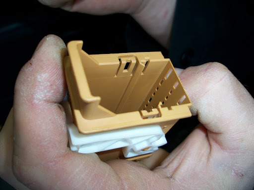

Fuse 16 will be for our camera. Remove the locks on the back, and push the red wire from maloosheck's harness into the open end of fuse 16. Add a 5amp fuse to #16 when the install is complete to avoid blowing the fuse and making troubleshooting more difficult when the camera doesn't turn on the first time (ask me how I know!).
Follow the DIY on here for upgrading from a lowline to highline CECM for instructions on removing the CECM itself. We didn't take many pictures from this point on, and the ones we did, were all blurry. Take note of the locations of the connectors, on my car A = black, B = white, and C = brown/tan/gold. Once you get C removed from the CECM, you'll need to remove this colored "lock" on the connector by manipulating the little arms at the top and bottom of the picture above.
Now, you'll need to use Maloosheck's harness with the yellow wires to tap into pin 28. Use the pin removal tool to remove the current female connector, plug in the female connector from maloosheck's harness in its place, and then plug the male connector from maloosheck's harness into the female connector that used to be in 28. Then use heatshrink to isolate the yellow male/VW pin 28 connection.
